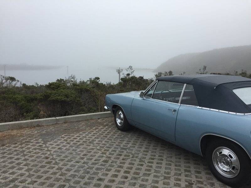

This is what it can look like. This top was professionally installed over 20 years ago.
