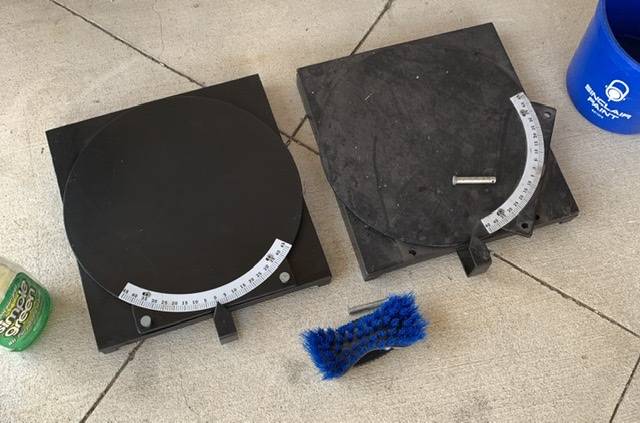

                                      I just bought these Turn Plates for $150 used a few hours ago from a circle track racer…. to go with the Longacre caster/camber setup I already have.

                                        If nothing else, doing it yourself at least you'll know your sh#t is tight.
                                        • Agree Agree x 4
