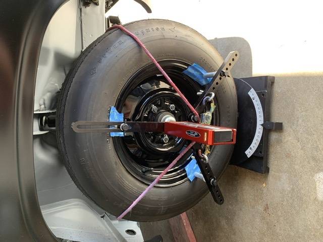

My lesson is, unless you are pretty crippled up learn to do it yourself. Unless there is some "really weird" problem such as something bent / broken that you haven't found, it is just not that hard
WHAT YOU NEED
1...A level place aka slab. I don't have, so I jack up my car trailer level after the car is loaded, and use it for a "rack"
2...An accurate way to measure tilt (degrees) reference to level. There are many ways to do that esp. with all the digi levels available, OR buy a caster/ camber gauge BUT YOU DON'T need one, just something to measure tilt
3...Something for "turn" plates and to allow the suspension to "settle". Many things (do a search, front end alignment turning plates) and there are ALL KINDS of solutions, including greased scrap sheet metal
4...You need something for toe. "Crackedback" says he just puts a pair of short 2x4's against the tires jacked up on soda cans and then measures between, front and back. I actually got myself a toe gauge (that I had to modify)

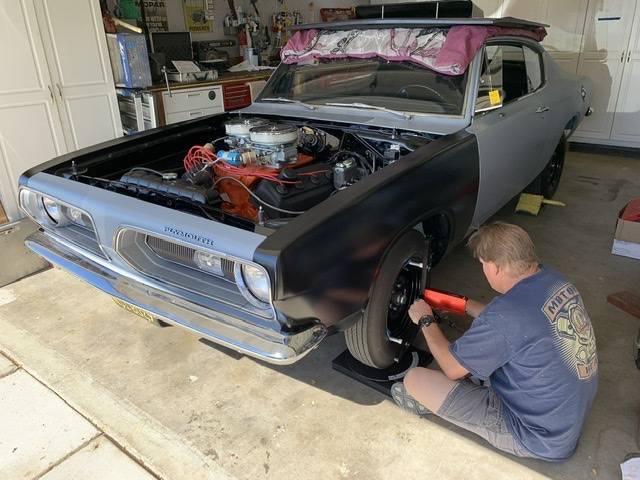

I do my own at home!
No "average" shop today knows how!
I can do better with a tape measure and speed level!

Slip plates and alignment heads. I like it. You can do a pretty good job with those. Oh, I cam set toe with some string and a magic marker but it's a long way from being right.
