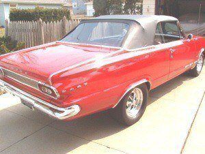

I have a m/t slick 15x10.5"x26 on my 65 ragtop , stock location super stock springs . section width is 11.1". bulge to bulge . Nothing trimmed off on the outer wheel wells or molding.
Crager SS wheels 15" I think the space space is 4.5".
8.75 rear end.
Everything fits great ! !

Man! I can't believe those things fit with the springs in the stock location. The Darts and Valiants must have different width wheel tub or something because there was no way that size tire would have fit my Valiant.
It looks great.
Looks like crager wheels did there home work with the correct back spacing on these new wheels for abodys. these have the 4" bolt pattern. These leafs are super stock also. correct abody rear end. 8 .75
