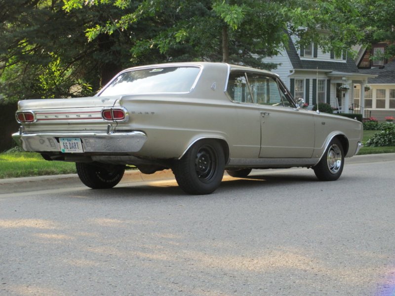

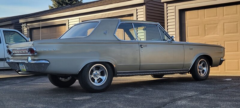

pics of my car before with 14" steel wheels, and after with the 17" wheels.

Cool look but 2 things, you are running 17" diameter with no mention of width or backspace.
#2, Your Dart is not an early A body like the OP's 65 Dart. 2 different cars except the fact that you can't run 8" wide wheels either without some modifications.
Yes I agree with toolman. You definitely want to size them up on your own car to see what your car will measure out to.
