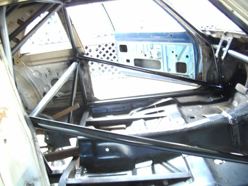

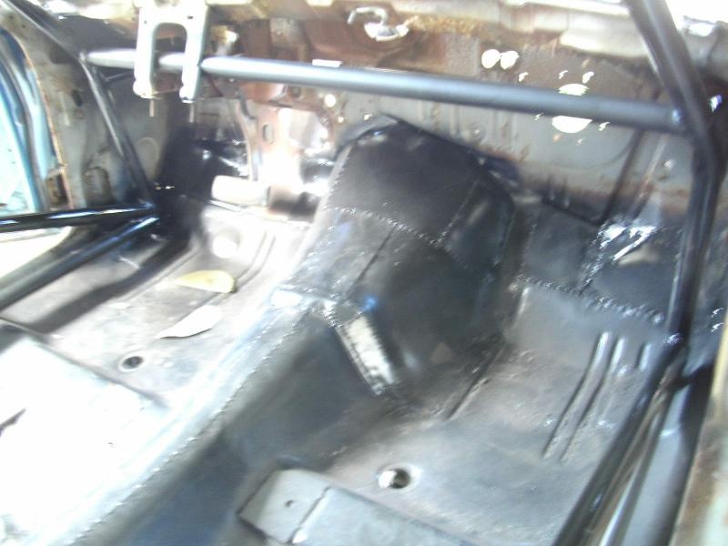

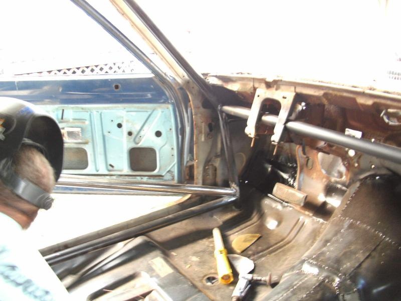

Ok, both front bars are in, the door bars are in so the cage is done. The front floor and tunnel are done, there is still some tacking left to do but it's basically done.
Roy I'll call you this week to discuss what we are doing from here.
