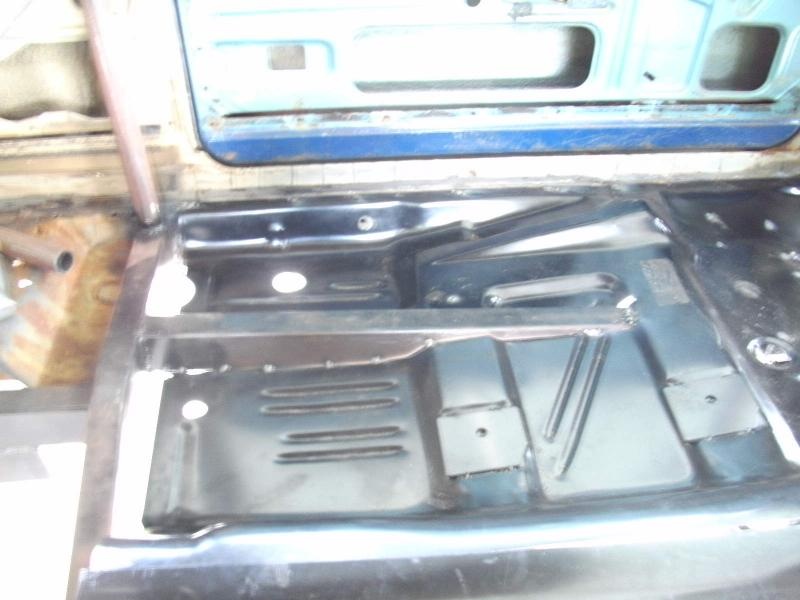

OK, I know it's been awhile again, my work schedule is all screwed up as we are now open 7 days a week. But we do have the floor in and can now start on finishing the cage. We had to cut the new floor in half as there was no way it was going in there in one piece. That works out OK though as we will have to stretch the trans tunnel to fit the CSR trans shield anyway.

Thanks guys, I know it doesn't look like much but all this stuff is hand fitted and takes a good deal of time.
