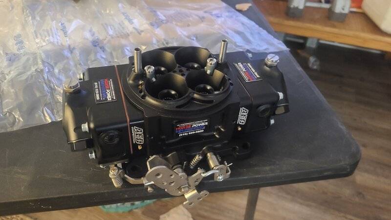

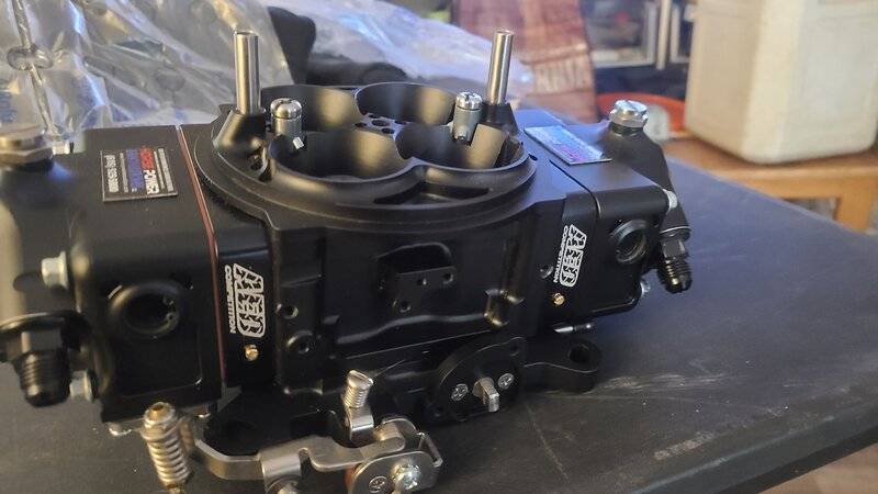

I still haven't got my e85 blow through carb yet. Been five months. But I have made my 950 quickfuel work (low boost anyways).
Turn the timing down and this thing is spicy even at 6ish psi and sounds like a friggen jet. Totally cool.
I have also swapped out the pancake style hat that came with the kit with a holley carb hat.
Obligatory pictures.
