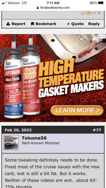

I was gonna suggest The Right Stuff but this advertisement was one step ahead of me.
