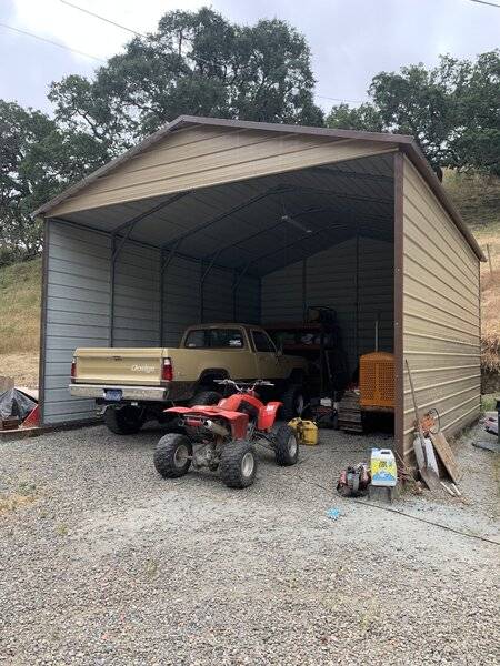

Makes sense, gives the tracks something to bite into. I also like the fact that wood is somewhat of a "consumable," so if you make a boo-boo, you replace one plank and go about your day. Say, is that your new shop in the top left??
So that was the first one I got, 20ft wide X 25ft deep. It’s not really a shop, more just a 3 sided enclosed carport, set on railroad ties. I leveled an area and put a gravel floor. Something to park my tractors under & out of the sun mostly. But it proved to be too small and filled up quickly.
