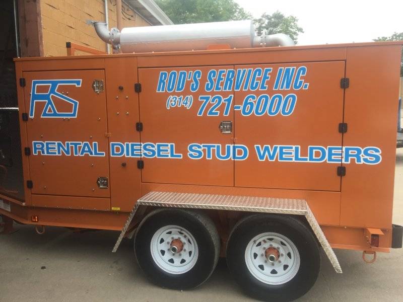

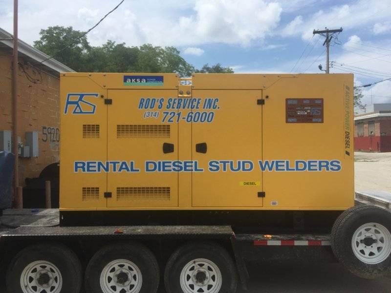

The Hankook LT we switched to are 14 ply. Our trailers get a lot of tight turning done and I have found they hold up well.
We run some pretty heave trailers though and are on construction sites so they get abused

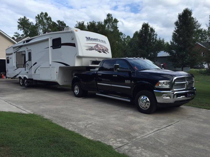

This is my trailer, almost 8000#, I would never consider running an LT tire on it. I stick with tires designed for the loads that they are made to handle. There is no light truck out there even close to the weight of a large trailer.

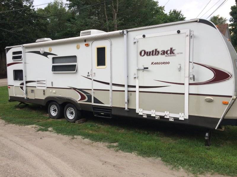

That's what I've always thought. Just exploring options.. Here's mine:
