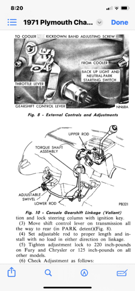

Update for the group the trans is in the car just need to hook up all of the lines and the electrical connection. How does the gear selector hook up to the transmission?
There's a shift shaft on the driver's side that pokes up there should be a lever on that
sounds like a neutral safety start switch
This is console mounted shifter.
This one is column mounted shifter.

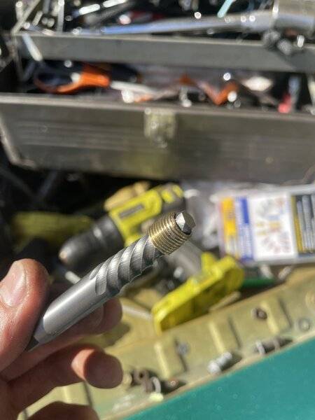

Did it get hit during install or did someone Tim Taylor it?
Some thread sealer on the threads.
And tighten it lightly.
Use a backup wrench on the fitting while tightening the tube nut.
Flare nut wrenches will save a lot of grief
I was definitely the problem I went to push the line back to tighten it on. Instead I yanked it back thinking it would just bend the pipe a little and it snapped the fitting.
It happens, if I tighten it just a little bit more....Snap!
