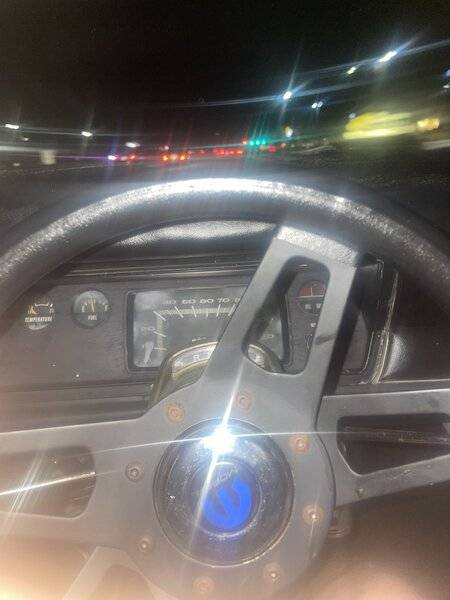

The dart is back. All three gears now she is ready for her 6 hour trip to Norfolk VA.
I know that feels good.
