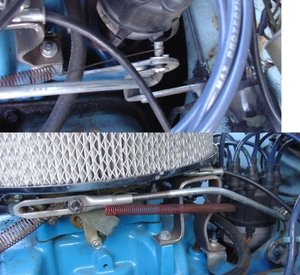

Is this what it looks like at your carb? Set it up like this and then, if need be, we'll go under the car.
ok, it looks like that with a slot. i have it adjusted with no gap on the firewall side of the slot, all the open side is to the front, in front of the bolt that attaches to the carb. further back at the piviot linkage where the kick down rod snaps on, i have the rod at the higest point, verticle. it is spring loaded and go there without any resistance. i then attached it to the piviot. therefore, no preasure but no slack either. now i added tension or length to the rod and it still waits too long to shift. i added more length (i have a 1/2 inch of the rod pushed down at rest at this time) and it does not shift soon enough. this also does not allow the carb to be full open due to the kickdown rod being fully depressed. that is the current state of the car. i decided to stop till i figure out what and how much to move. hope this is understandable. i would take a pic but it looks just like the other post. i know the items are in the location correctly, just don't understand how much slack or preasure to have to make it shift sooner. sorry for the long version.
I fabricated a new rod using 5/16" round stock bent to the proper angle and ran a die over one end. So far, it's working like a charm. Ignore the ugly throttle cable bracket treatment.
