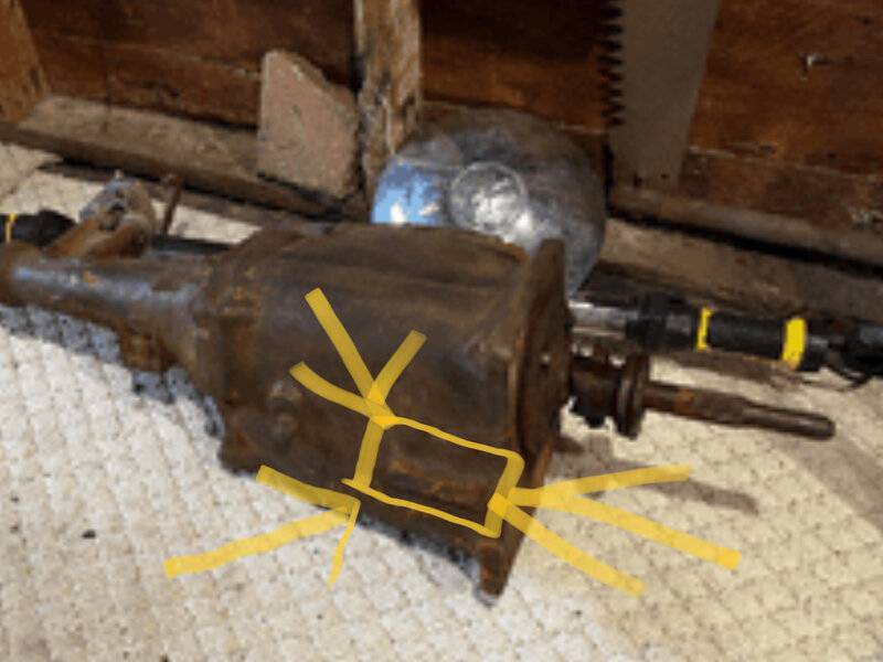

Can you guys help me identify if this is a A833 a body trans? I'm looking to possibly purchase it for my now 904 equiped duster.

There is an O/D version and a non O/D version of the 833. Make sure it's the one that you want.
Looks like the large bearing retainer so OD trans is likely
tell us all the numbers from this raised pad on the side.

There is a bit of work....tunnel, installation of the z bar linkage, installation of pedals plus parts - bellhousing, clutch and TO bearing, shift rods and shifter. I believe the OD trans has the low 3.09 first gear. Do you know what shape the A833 is in? Your crank needs to be able to accept a pilot bushing too....not sure if they are all drilled for one or not.

The trans comes with an engine as well not sure if he has a bellhousing as well
That raised pad will have stamped info. Hard to get a good photo. Write it down and post it here fora decode.
that raised casting number doesn’t mean much.
