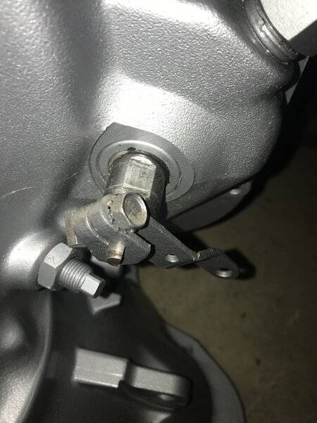

The pressure lever is the upper lever, and the shift lever is lower lever...
Here’s a pic, I don’t have the lower lever (shift lever) on right now, but you can see the flats where is goes.
