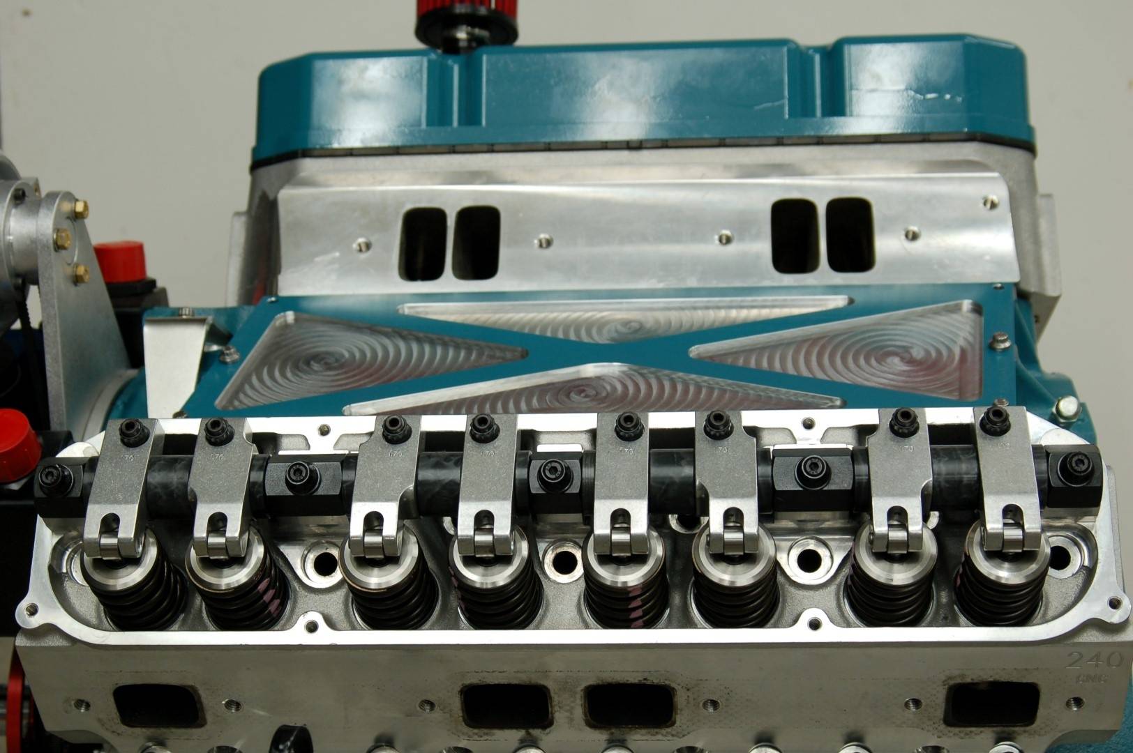

The T&D rocker arms showed up. I think these are the very first set of T&D rocker arms for the Trick Flow heads. They had to shorten the spring side of the rocker arm a little bit to get the correct sweep pattern and the spacers are different than the standard 440 set. They look great but I need to order some pushrods before I can try them out.
andy, I`ve got a brand new set of 9.400 compcams 3/8" stock ball and cups I`m not going to use, if u need some that long. course the can be shortened as u know.

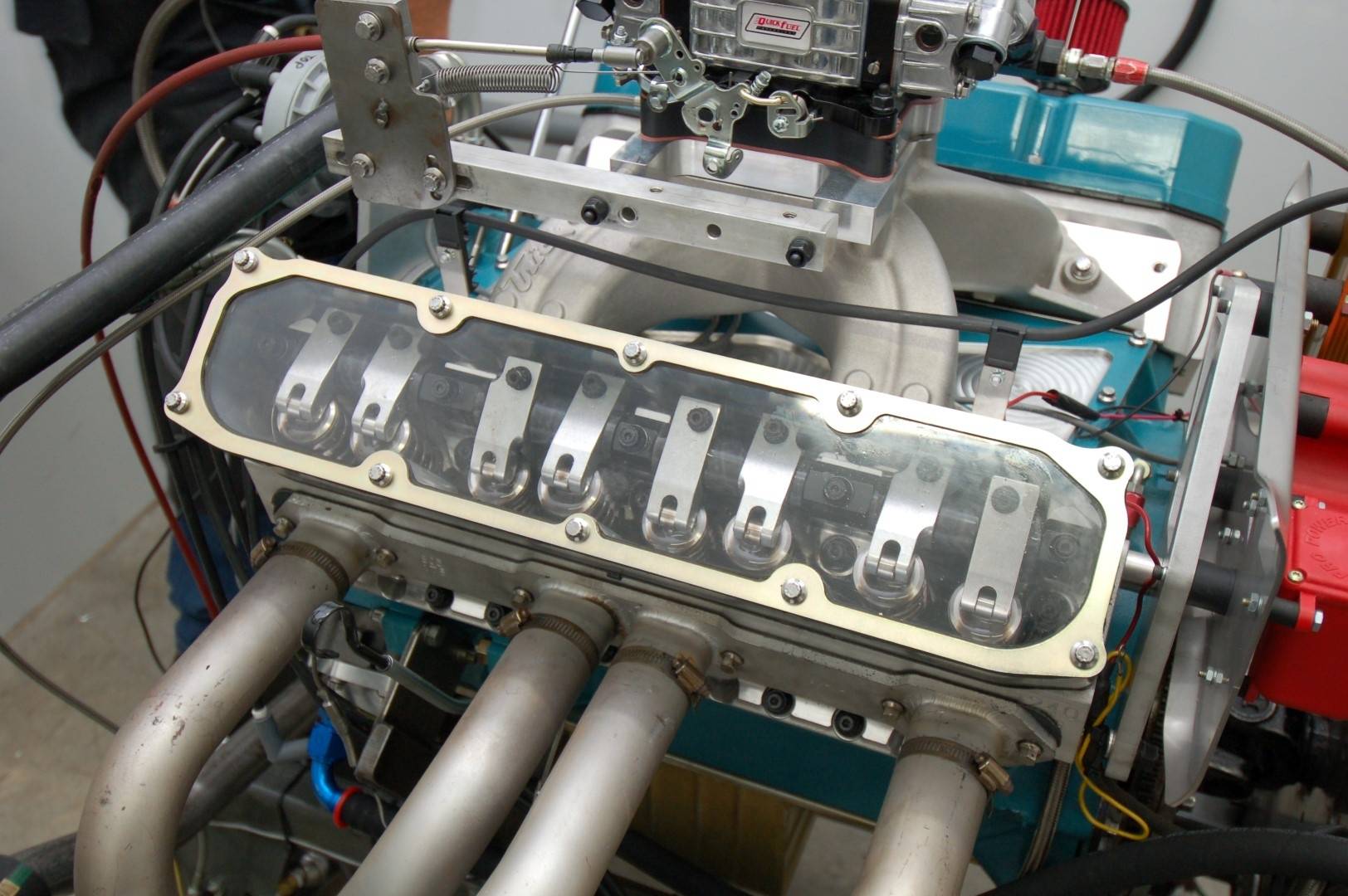

I clicked on a subsequent video of the valve train on start up w/ the clear covers on. sure seemed like an eternity for the oil to get up there. is that normal / also tell us about the valve covers, think their neat as ---- !
Yes it takes a long time for the oil to start flowing out of the rockers and this was with a primed system at room temp. I bet it takes twice as long for the oil to start flowing on a cold engine that has been sitting over night. I'm also using pushrod oiling so you would expect the oil to get there really quick but it doesn't. Tells you that you shouldn't wing the engine right after starting it!
Valve cover is custom built for dyno work. I use it to watch the rocker arms and make sure everything is working properly. Makes it easy to see if you've primed the rockers or if you burned up a pushrod or anything like that.

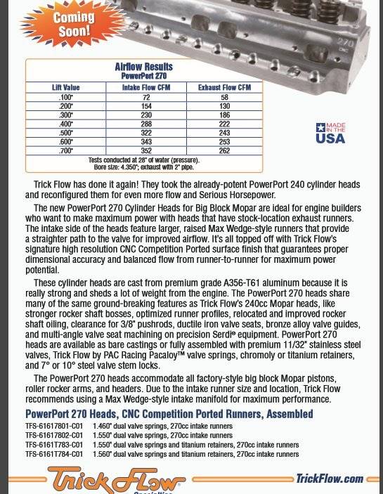

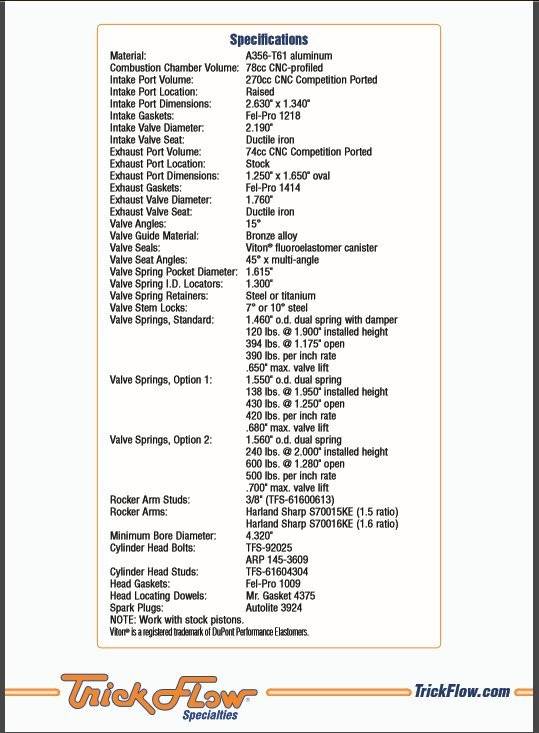

Just got this email from TrickFlow.ooo
Subject
Big mopar cylinder heads
Discussion Thread
Response Via Email (Harold)
09/15/2016 11:56 AM
Hello,
Yes, we will be making a 270 (max wedge style) version soon. I attached a pdf of the specs.
Thanks,
Harold Miller
Trick Flow Tech
Ph. (330) 630-1555
Fx. (330) 633-2504
Customer By Email (frank famieano) 09/13/2016 06:16 PM
I heard that trickflow was making a new version of the 240, the 270 would like to know if there is any truth to that. If so when will they be out and is there any information you can tell me about.
Question Reference #160913-001544
Date Created:
09/13/2016 06:16 PM
Last Updated: 09/15/2016 11:56 AM
Status: Waiting
Order Number:
Phone or Fax Number:
Trying to find out when they will be released for sale.
Looks like they should be released sometime in November, looks like ill be waiting till then.
