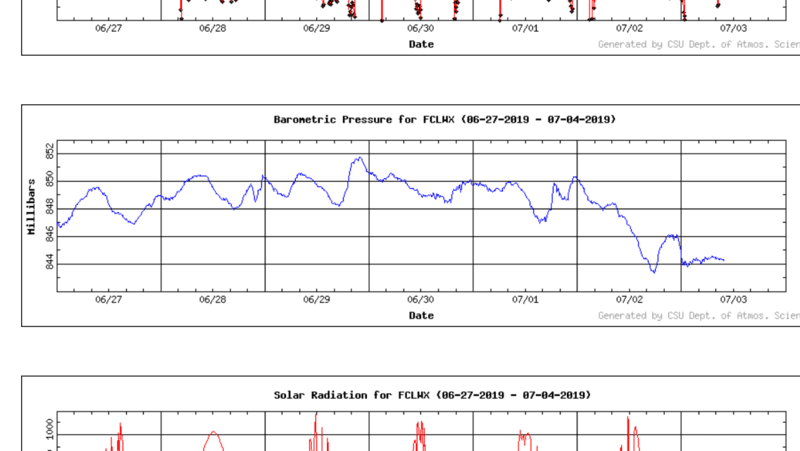

Here’s the baro pressure for Fort Collins over the last few days.
Uncorrected, in Mb. To convert to in/hg divide by 33.864.
Yesterday, from mid-day into evening....... 846mb down to 844mb....... or .....24.98 to 24.92 in/hg.
Looks like the highest pressure in the last few days was 6/29 around 11pm....... 851.8mb....... 25.15”hg.
