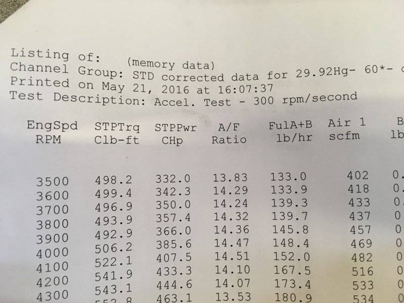

I find it interesting that the air fuel ratio would show that much of a difference from one side to the other? It makes me think about the one that I have that's just on the driver side and I always would assume that the passenger side would be very close not the possibility of a complete point of difference one way or the other...
Is there any indication on that sheet depicting whether or not the tq/hp numbers are corrected or not?
Are there any fuel flow numbers(in lbs/hr)and bsfc numbers?
“Usually” there is some type of heading so you know what type of data you’re looking at.
You'd be surprised at how far off each cylinder can be when you have O2 sensors in each primary.
It doesn't have any data listed. At the end of the run It pulls up the graph and the chart. And then you can print either from there. I'm currently at a parade. So Happy Independence Day!

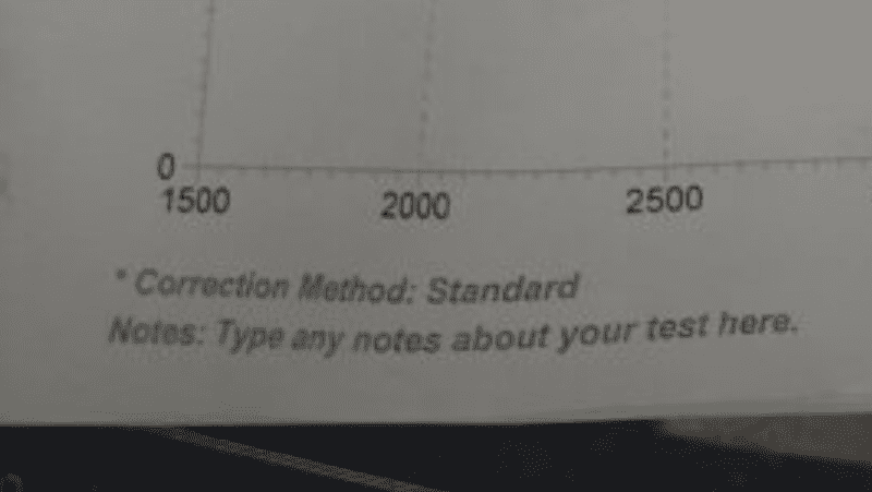

Looked at the original graph again...... saw this down in the corner after I blew up the pic:
If there were fuel flow and bsfc numbers available, the uncorrected power could be calculated.
Plugging the OP’s weather data(25.7”, 90*, 42.3%) into the Wallace Racing dyno correction calculator..... it spits out a 20% correction factor for SAE J607.
So, for 546hp corrected...... you’d be at 455hp uncorrected.
The only caveats about all of these corrections is....... they were never intended to be used for correcting more than a few %......... so at a theoretical 20%+ correction........ the accuracy is not likely 100%(it never is anyway).

I merely pointed out that I saw where the graph did in fact reference what the numbers were depicting......... which is std corrected.
Using the weather data provided, it appears that correction is to the tune of 20%........ so the uncorrected, or “observed” hp numbers during that pull should have been in the area of 455hp.
