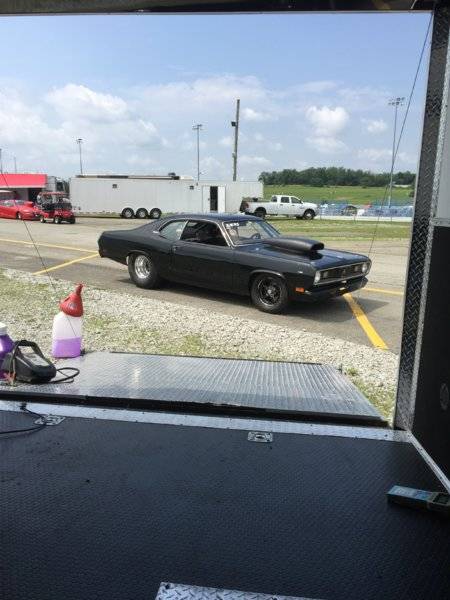

At the track again today on a 86 degree day (3428 corrected alt) and in the Upper 60’s dew point. This is year 4 on this engine with 100’s of 6’0 passes. When you race more times in a month than most do in a year you learn how to treat your equipment.
