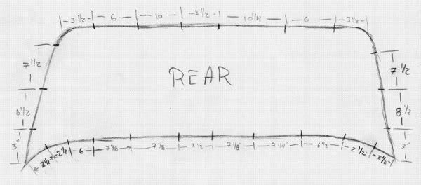

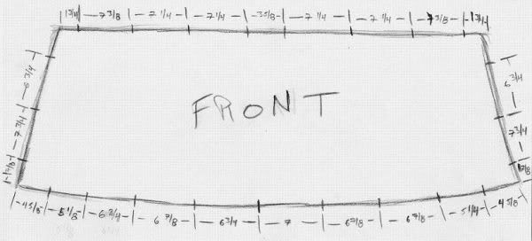

I copied these from somewhere months ago...hope it helps
Thanks for the feedback it has been helpfull
