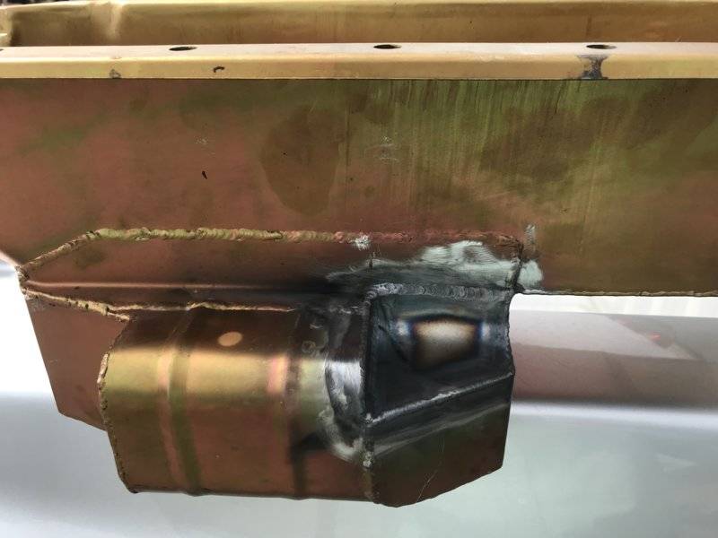

Update: I still wasn't satisfied with the clearance I got with the heat and C clamp. I pulled the engine and took the oil pan to my fabrication friend.... this is what I got back. Figured I better just do it right and be done with it. Also wrapped that header tube since the engine was out. All should be good now. Is this pan zinc coated? Should I just spray some engine paint on the pan or does it need to be some sort of zinc coating?

That's a nice fix. Rattle can that thing and go drive.
good call (see post #4)
i would paint it gold and call it good, in fact, that what i did when i owned one of these pans, and had to have it fixed some)
on a side note, kudos to your fabricator buddy, his welds look much better then the stock welds on that pan

now that's the proper fix , very nice .
Thanks guys. It was definitely worth pulling the engine for. His welding skills are phenomenal. Now I just need life to slow down a bit so I can put the engine back in LOL.
I want to say that is Cadmium plating, but could be some form of zinc. Paint will work fine for corrosion resistance. I'd use a hi-temp or engine paint since it is still pretty close to that header tube. Congrats on doing it the right way. Hard to make that choice sometimes.
