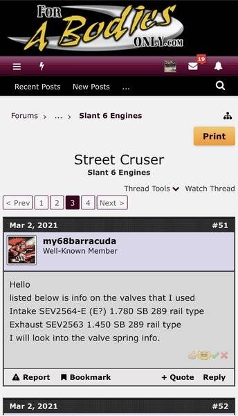

If i use the comp 901 valve springs what other suporting parts/mods do i need.
