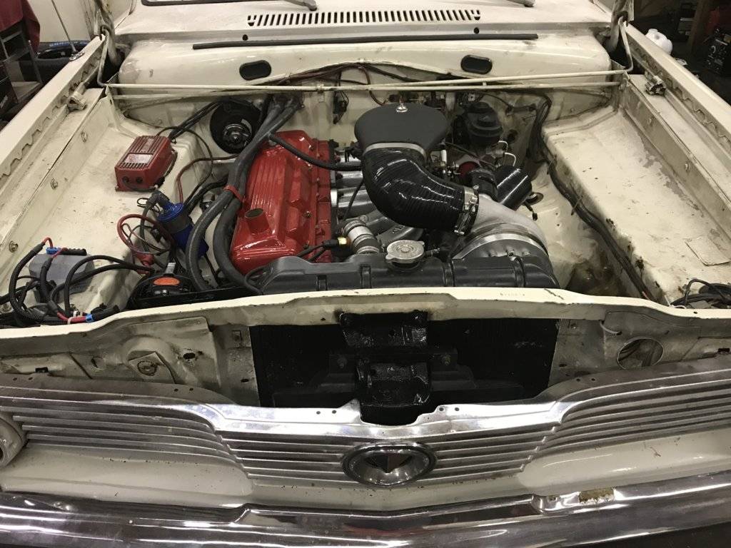

whitepunknitro just did my supercharged slant. If you have questions fire away

Pishta my slant has reclaimed its youth and then some with my Torqstorm blower. It will move with spirit under boost and I am using an electric fan instead of stock fan reducing parasitic loss.

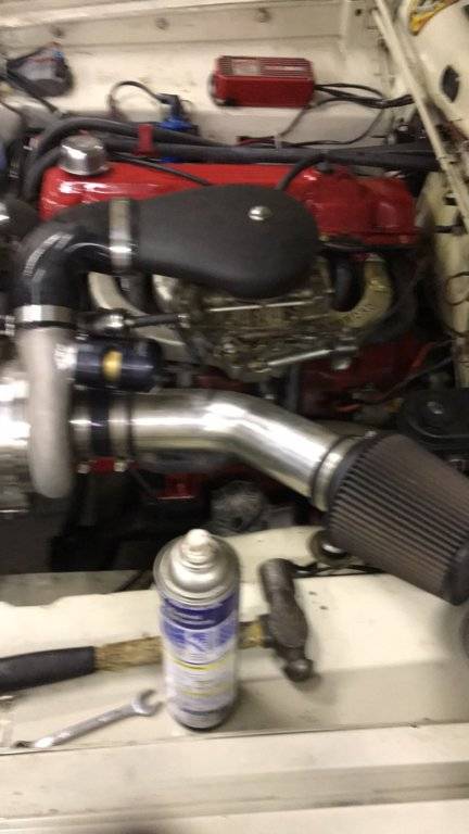

Mechanical fuel pump boost referenced to the back of carb hat. 3/8” fuel line. Holley 600 cfm 4 bbl with secondaries closed off for now
I have a /6 fuel pump that I fastened a spud into the atmospheric weep hole that ties to the cold side/carb hat output. Its the poor mans boost referenced mechanical fuel pump.
