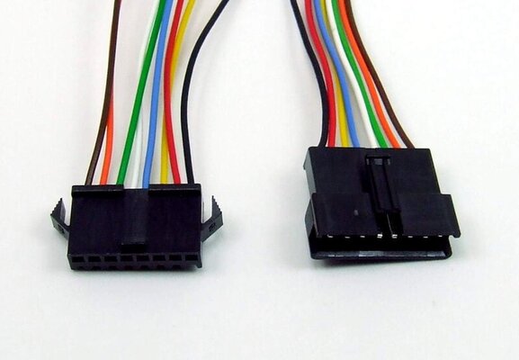

If you're not looking for a stock apparence, you can go for a both ends (male and female) connector replacement.
Generic connectors like these ones :
Reliable, easily findable on internet and cheap.
Hi. I have been searching and have not found the connector that you pictured. Do you have any information on what website you found this?
One of these might get you on the trail for a connector housing that will work.
whatever you do, make sure the terminals stay in place when halves are coupled together. Otherwise there will be intermitent contact
