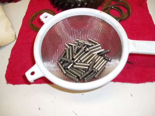

Installed it straight up and degreed. According to the cam card, an installed centerline angle (ICA) of 108 degrees is 4 degrees advanced. It came out to 108.25 degrees. Good to go. Just waiting for the timing cover gasket to arrive at the local NAPA ($2.88 vs. $34.95 for timing cover kit. I already have a spare water pump gasket and don't need the seal or partial OP gasket) and the intake manifold gasket from Summit and I'll be ready to go.

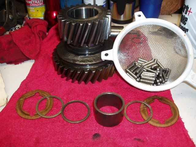

Yeah man, those NP203 T-cases are full time 4WD NP203 and are cast iron! I separated them when I pulled the trans the first time around. The good thing is that after who knows how many miles of serious abuse all I had to do was pick up a rebuild kit from Rock Auto and install it. The input and output ball bearings were all fine but I swapped them out for piece of mind. IIRC, I counted 174 loose roller bearings when breaking this thing down. No drinking beer on dissasembly or reassembly. All bushings and shims looked great too!

Great looking job detailing the trans. and transfer case. I figured they must have been very tough transmissions because My buddy Steve was young and crazy and drunk half the time when he was in it. We lived in a rural area so he was off roading alot. Got it stuck a few times and hammered on it hard back and forth to get out and it still worked fine when he sold it. It had over 100,000 miles on it when he got it so that tells you just how tough they are.

Thanks for the compliment on the drive train rebuild. So far, so good there and no problems. Tranny shifts hard under throttle.
