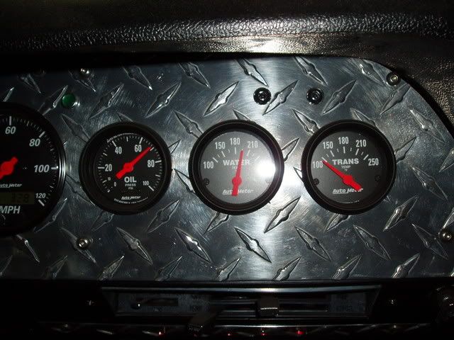

Oh yeah, at 195 degrees after 25 minutes of cam break-in at 2300 rpm I'm still running 69-70 psi of oil pressure.

Here's some oil pressure proof:
That thing sounds killer! Gotta love those Ramchargers. I'd love to find a decent 2wd to pro street.

No leaks no drips and no weird noises. Oil pressure is 70 psi hot (195-200) at 2300 rpm. I just about killed myself thrasing to get this done on Saturday. It was well over 100 F here and I think I dehydrated myself even though I went through about a gallon of Gatorade. I wasn't worth a crap on Sunday.
