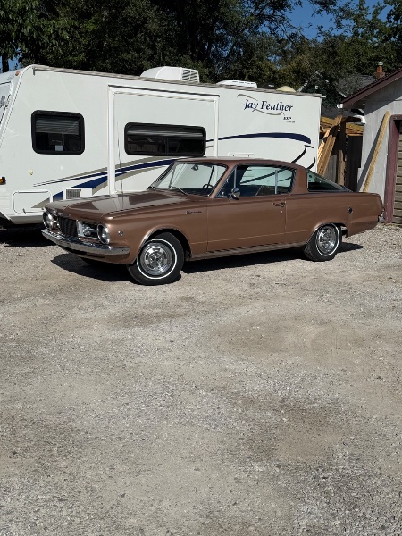

Upgrading my ignition system on my newly acquired 65 Formula S Barracuda. Any suggestions on equipment I should buy? Experiences? Thanks so much!
