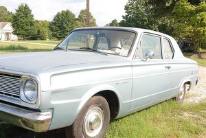

Well have gathered up enough parts and pieces to do a little mock-up on the valiant....cut-out the trans tunnel today for the 4-speed and slid the motor and tranny in for a trial fit....fits like a glove....so far so good
Buddy dropped of a 360 block today also....if it ck's out, looks like an upgrade from the 318/390 to 360/408 is in the future plans....again
Also scored a brand new never mounted race-weight fiberglass hood, so I won't have to carve up the stock hood
Also flipped the front spring hangers and installed 2" lowering blocks, it's sitting just about the way I want it to now or will once I replace the 23" stock front tires...lol

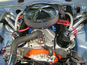

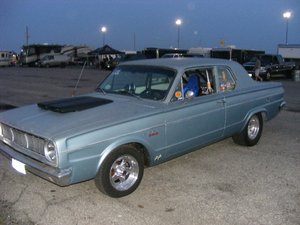

Lookin good!Just finished a transformation myself on a 66 Dart.I,m almost in the 10,s,hopefully this weekend will hit 10.99 LOL.Any questions,feel free to PM.

One ???? for now.....who's headers are those and what size....?????
