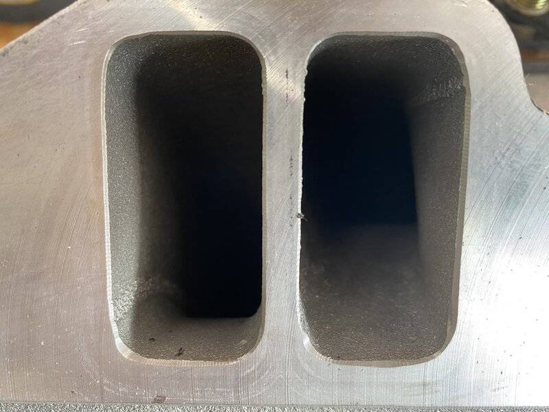

Weiand Stealth 8022 - bad ports, can it be fixed or should I send back?
How many times will you have to send back till you get one you can just bolt straight on? Shipping Back and forth is time and possibly $$$ if you pay for additional shipping, porting it is $$$ and time. Just lay a gasket on it, and open the windows up and then blend in as far as you can into the ports. Expect to do that on any new Weiand, Action+ included. Or if you truly want something ready to bolt on just scrounge up a little bit more coin and get an Air Gap and slap it on out of the box. Because you can with those, Weiands you can too but you’d be better off finishing up what they don’t. I’d be hitting it with the grinder

They must be imported as you say, an Action+ I bought 4 yrs ago was pretty nice and uniform, packaging touted made in USA. I just opened up the windows and tapered into the runners. Referring to the two questions the OP initially asked: Can it be fixed? Sure. Could just be any old typical day spent with a grinder opening and straightening things out as some have shown here on other intakes or it could be a major undertaking to get it right or one might end up breaking through a runner. Send it back? For many absolutely. Why bother, unless you just gotta have a Weiand. Maybe it’ll end up on a Jegs “seconds and irregulars” blowout sale, then it might be worth trying to make it right!:rolleyes:

I picked up a Weiand Stealth 8022, and it has really bad port windows as shown in my images. My question is, is this indicative of bad ports all the way through or is it just needing the port windows to be gasket matched? I am curious if that is something that will affect the entire runner from those who have seen this before.
Should I just send it back? I ordered it through Jegs.

I wouldn't expect a replacement weiand to be much better, i would return it for an edelbrock rpm too.
But everybody is capable of bad work. This is a late production edelbrock six pack manifold, the core shift and port windows are horrible.

We’re cleaning up the Weiand Action Plus intake bought from Summit in 2017 in preparation for engine assembly and got to looking at casting markings, recalling this post about the horrible casting of the Weiand the OP received and noticed the one I have has the well known BB logo on the underside. Looking at he OP’s pictures I see on the underside what looks like the same BB logo in the same location as the one I have. That pretty much means it was cast/made in the USA you would assume right? Or are the Chicoms replicating the BB marking as well??
Mine:
OP:
