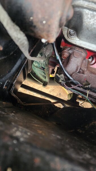

Oh yeah, there is a starter, i was looking on wrong side of engine. Is there normally such an oper area to the bell housing? I feel like i am missing a cover down there and i can see way too much flywheel?

Your m
Your missing the lower bell housing cover
He told me he just had an exhaust put on b4 it stopped. Now i see why the cover isnt there, the passenger side pipe is in the way. I personally would of made a notch in the cover, but whatevs.
