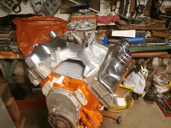

Pic from last summer. This will give you an idea of how big a tub my poor little car has to deal with driver wise.
