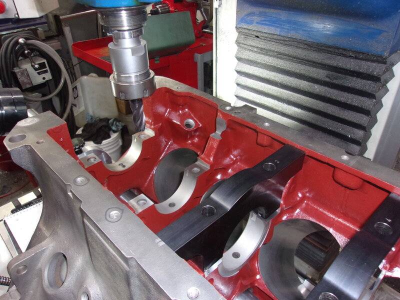

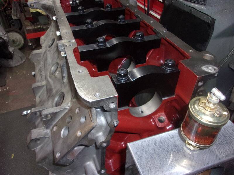

I have the inside of my 408 coated with Glyptal. When I sent the block to the machine shop, my machinist suggested it. He baked the block to burn out the oil in the porousity of the block and I took it home to paint it before the machine was done. That was 15 years ago and it still looks good. I can't say how much it affects the oil drain back, but it may help with it.

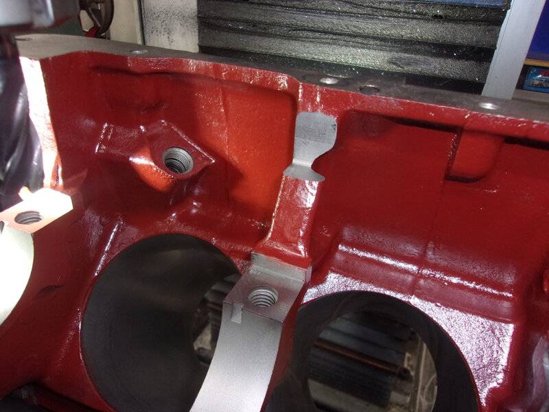

Glyptal coating. when the block is clean and dry. Helps the block from retaining oil and any break in particles from sticking. Oil flows to the sump faster. Steve has customers that request it at the machine shop. Usually done before machine work . Block must be spotless and dry

I've painted the insides many Mopar motors with Rustoleum damp proof red primer and or Glyptal after having them hot tank after all the machine work was done, I use both Shell Solve 360 cleaning solvent (or its equalivent(SP?) of another brand and then cans of a good brand of spray brake cleaner that doesn't leave a residue to make sure they are really clean:thumbsup:

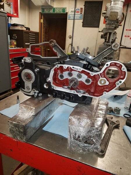

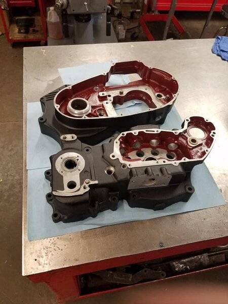

I just did the full inside of my 360 block with red glyptal. My impression is, you ever tried to slide barefoot across course concrete vs. polished concrete? I would think oil likes to slide down a slicker surface. Just my two cents but to each their own. Do the proper prep work like I did (wipe down the inside with acetone on a cloth then use a handheld torch to help cook oil out of the pores) & I would see no problem of it flaking off.

Two reasons to paint the inside of the blocks, especially BB Mopars if you have used a grinder to deburr the casting flashes inside those blocks. The paint will seal the pores and trap the microscopic pieces that were ground off and imbedded in the block. The second thing is for oil return, especially on any motor using a stock small capacity pan like most small blocks and a lot of the pre 1967 BB. or any motor that has 4 quarts and is drag race and revved above 5000 RPM. I like using the 1970/1971 stock Mopar 6 pack and street hemi oil pans, they hold 6 quarts in the pan and, depending on which oil filter you're using whatever amount of oil it will hold. On BB you can drill all the small depressions in the lifter valley where oil will pool to make sure most of the oil drains back into the oil pan, I'm not talking about half a pint or more, I'm talking about maybe 3 to 6 ounces at the most:soapbox: but every drop in the oil pan is available to be used for lubricating:icon_fU::thumbsup:
