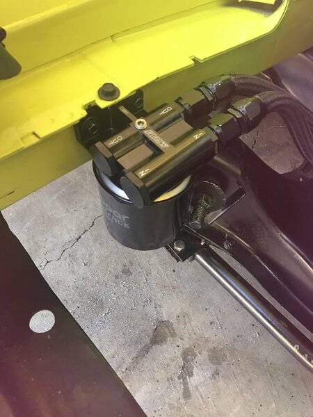

Finished my engine oil lines off today (this is a RHD car). Just managed to get -10 90 degree fittings into the block and past the steering rack. Drilled and tapped the remote housing so that I could vertically attach it to the top overhang bit of the chassis rail and used Chrysler type self tapping bolts into the rail itself. Had to fight the hoses every inch of the way but it’s done now!
