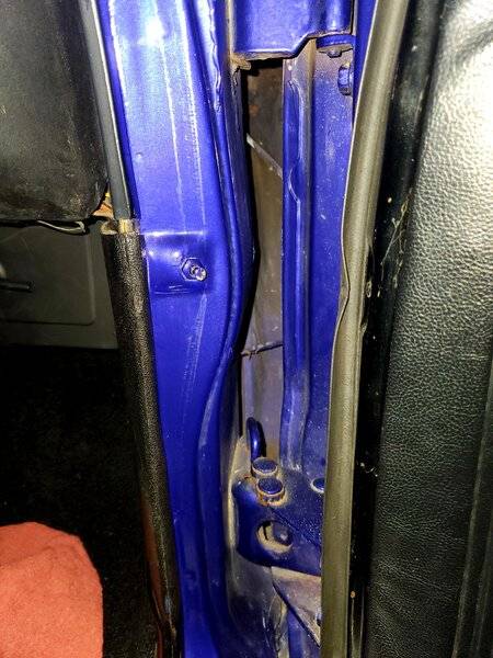

I turned the switch headlight switch it didn't work. I'm going to get the right bulb (1004) before messing with grounds or door ground switches. I also think my current switches are hitting this rubber seal instead of the metal on the doors when the doors close.
Ps- yes I know my door cards need fixed... its on the list... everything is on the list... I need some ideas for some projects that are cheap...

Did you try pushing on that door switch to see if it works?

I'll take a picture of mine if that helps you?
Does it not have to hit metal to ground it and turn it off?
Nope
It is a "normally closed" push button type
With the door open, the circuit is closed and whatever is on the circuit will have power to it (in this case, the dome light)
When something presses on it (your finger, or, under normal circumstances, the door) it presses the button and breaks the circuit, interrupting the path and shutting of the dome light

Nope. Just test it with your finger. Hold the center pin from moving and use a open end wrench if you have the urge to pull the switch out.
There was a "technique" back in the day using a spare key loosely screwed into that door post just above the switch...
Anybody know what I'm talking about????
