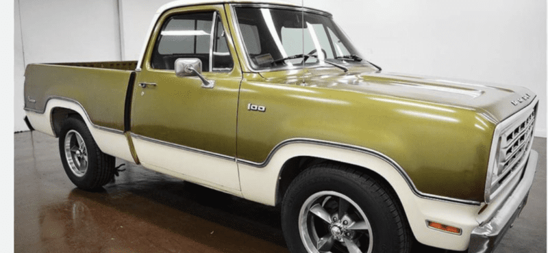

@Princess Valiant shortbed? Fleet side? Wanna sell it if both of the answers to the above questions are yes.
It started life as a step side but either the factory or someone put the tool boxes on, which is the main reason I bought it because I wanted a tool truck because I am too lazy to lug heavy tools everywhere I go.
I'm not sure what a fleet side is but it is a shorty.
At this time I am not selling, because I want to play with it.
That's kinda cool! Better have good locks on that tool body!
That’s awesome. Very cool work truck. A fleet side is just a straight regular truck bed.
