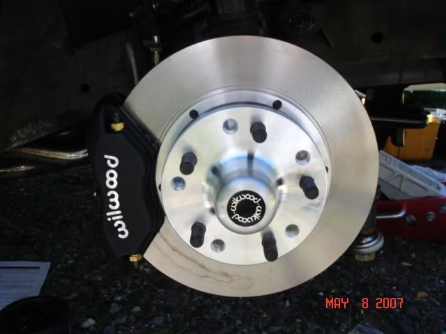

It seems as though everyone is very happy with the Wilwood kit so I may go there for a solution unless anyone thinks I missed something basic.
