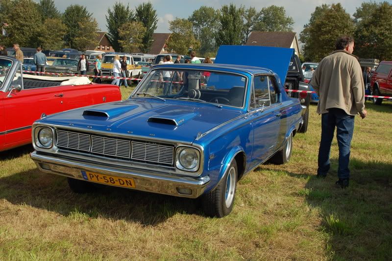

i love these demon scoops.
Ive seen this 66 dart on a show, which is a real mean car.
Anyone ever seen a demon scoop on a 66 dart?
