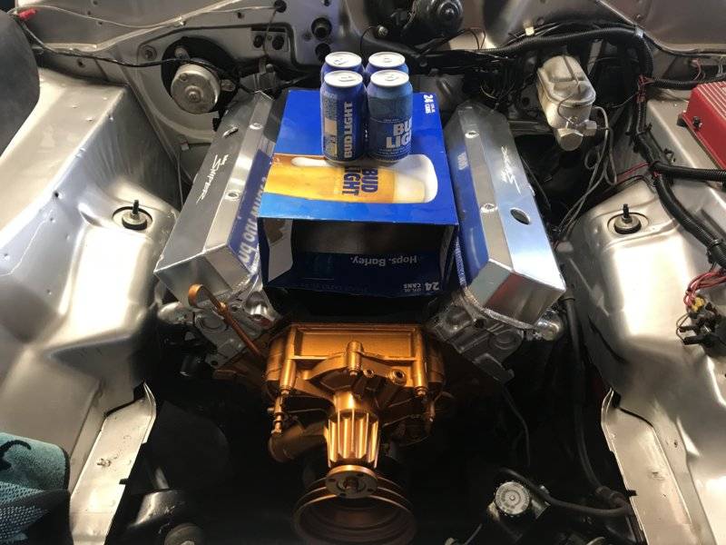

It’s a 408 stroker near .565 lift cam X heads and a 4:10 rear gear with a 727 reverse manual valve body and a 3800 stall converter.
should I use a victor intake or an rpm air gap?

I feel the need to state the obvious that two more of those Bud Lights and you could have a Six Pack.

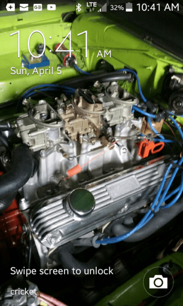

Victor 340 intake here. I just put one on my street 360. I have 3.91's and a 9.5" FTI 3400-3600 stall converter. I agree throttle response is sweeter with a single plane! My cam is on a 108° lobe separation. Holley strip dominator is another
