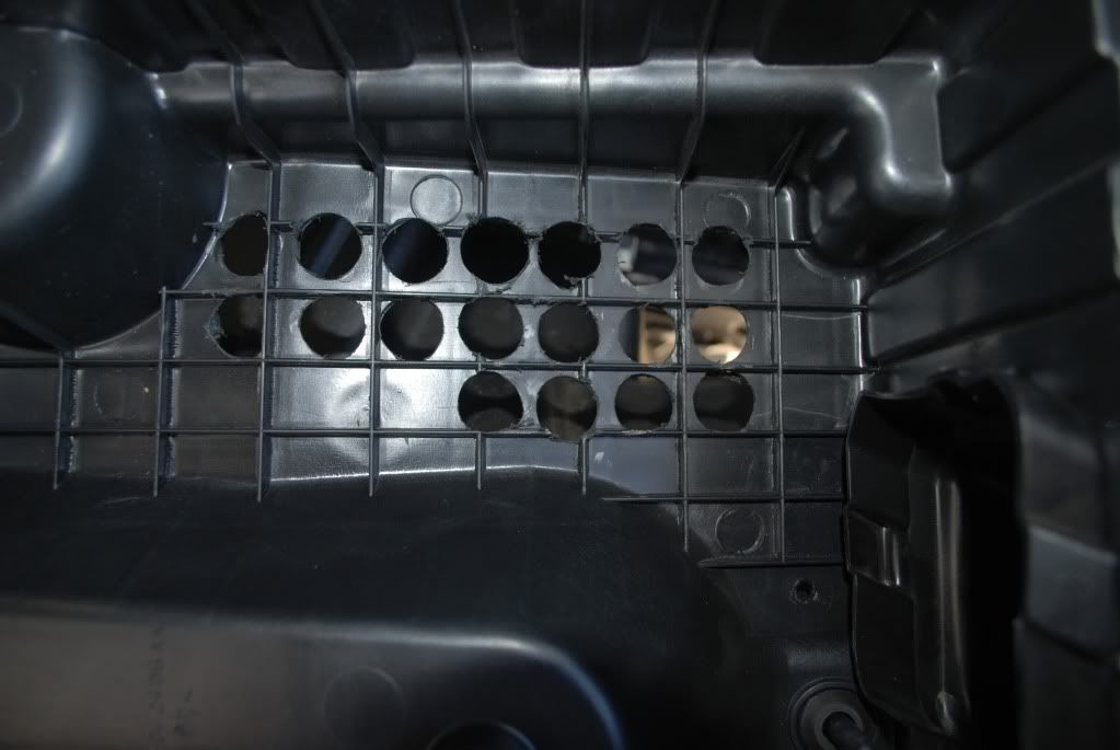

I cant remember where but if you drill holes in the stock air box with a drop in KN filter it was same as buying the high dollar cone deal plus kit. They tested it to see the difference another words.
You drill the holes before the air-filter. I did this on both my Dakota and my old 4Runner.
The cost is $0 if you already have the drill bit.
Here are some pics i found on the net. (links should work now)
http://i298.photobucket.com/albums/mm267/mogelfo/OEMAirBoxMod1.jpg
http://i298.photobucket.com/albums/mm267/mogelfo/OEMAirBoxMod2.jpg
http://i298.photobucket.com/albums/mm267/mogelfo/OEMAirBoxMod3.jpg
http://i298.photobucket.com/albums/mm267/mogelfo/OEMAirBoxMod4.jpg
Well I be... there you go!
I have a feeling that Plymouth 340 is out in the garage looking for his drill bits! lol
