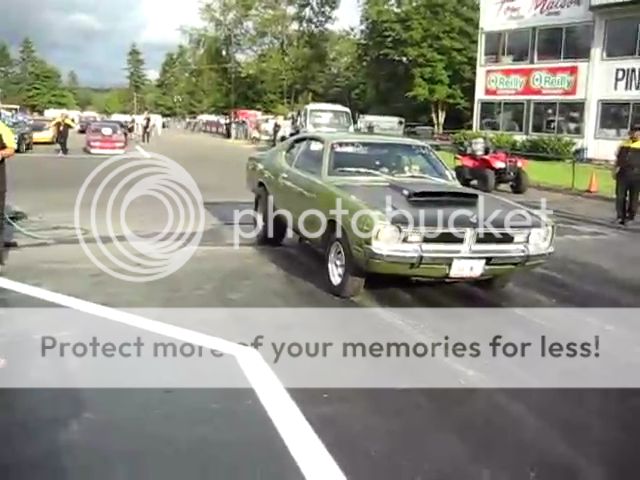

here is my dads 71 demon. has 10:1 451 with box stock eddy heads. 525 lift solid mech. lifter cam. m1 intake and 750 dp. 9" dynamic converter 3.91 gear with 30" hoosier quick time pro. full interior pump gas car. drive it 35 miles to the track, runs 10.60-10.70 at 127mph and drive it home. been on the road for 5 yrs now. fastest street car around our neck of the woods. he only plays with sport bikes on the street anymore. anything else is a waste of time.
[ame=http://i370.photobucket.com/albums/oo147/johnnydart_photo/dads%20car/dadscar003.mp4]
[/ame]
Very nice.... Id be more than happy with a set up like that.
