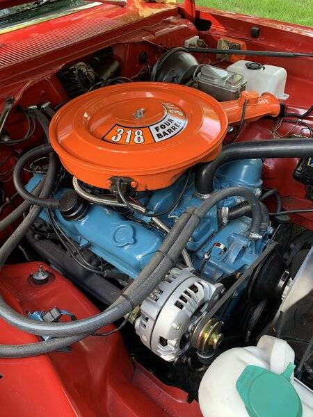

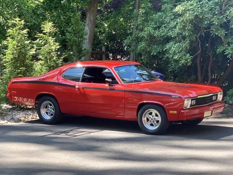

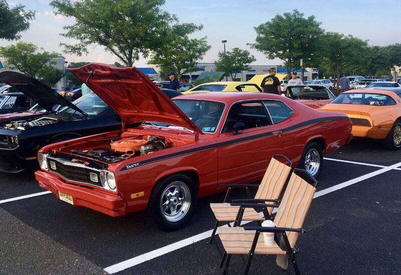

So I put this car back together with a driveline like it left the factory with.
318/904/8.25

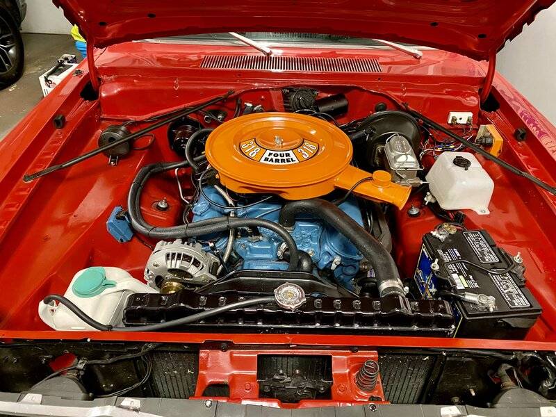

The motor is basically stock with Summit cam similar to the mopar purple cam. Added an Edelbrock 1406 on a Performer intake and dual exhaust using 340 exhaust manifolds.
The trans is stock with a Transgo shift kit. The converter is the factory stock “ high stall “ converter used on the 74 Duster 360.
The 8-1/4 rear now has a sure grip with 3.55 gears. I got the setup from Dr Diff.
Rear tires are 245/60/15. The car is fun to drive and when you mash the gas she will spin the tires really good and chirp them when the trans hits 2nd gear.
I just bought a set of 302 heads and I want to have them reworked with 1.88/1.60 valves.
I have had a few guys tell me to ditch the 318 and put this 302 heads on a new 360 short block and not look back.
I kinda like that the car is still 318 powered and the idea of keeping it sort of true to how it was built resonates well with me.
I was thinking of calling Hughes Engines and asking for help with building a nice setup using those reworked 302 heads. I know that a different converter is probably going to be part of the upgrade as well.
What would you do?
You have a lot of good going on. I would be tempted to keep it as is especially if it runs well. It's a really nice car.
I'm with Mike, if it runs well and you enjoy it leave it alone. If your looking for more power build a new engine. So what is your goal and how do the 302 heads possibly fit into that?

Especially if it can spin the tires and bark second. All more power will do for you is spin tires more may be to the point of out of control and burn more gas. It's up to you.
I have not thought it through yet. From time to time the idea of a 408 Magnum crate engine has popped into my head, but I’ve become attached to this 318.
More power, because a few guys said you should. You say you like it, keeping sort of true resonates well with you, and you are attached to the 318. If it were me, with the same feelings toward it, I would leave it as is. It's a beauty, it runs good. Wait, until there is a good reason to change it.
Personally, I would keep that car like it is and find another car to play with!

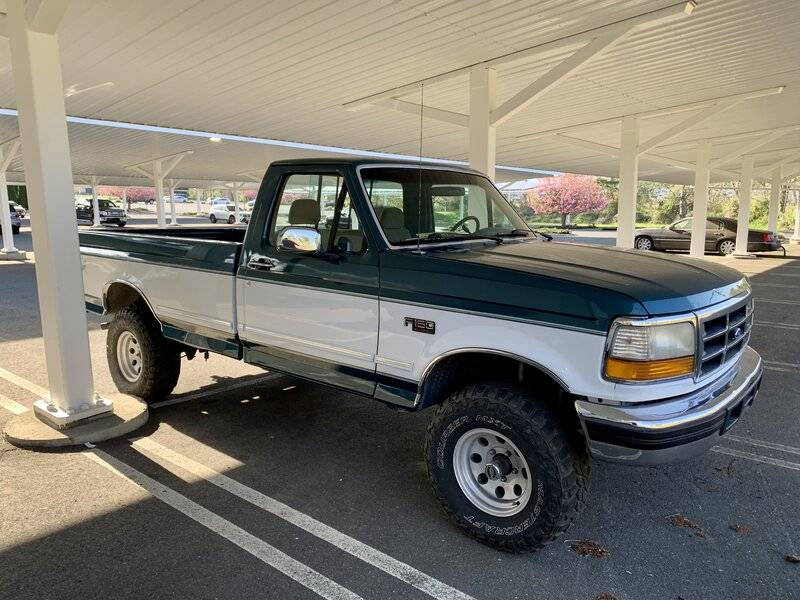

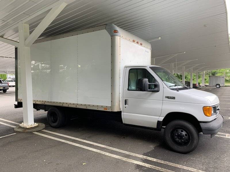

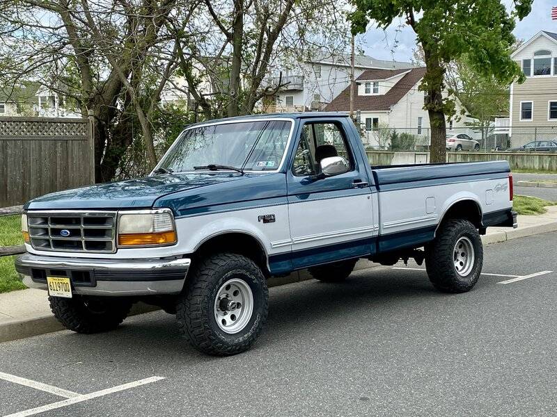

I already have this 96 Ferd I could not pass up! Had to add it to the gas guzzling fleet. Lots of new sheet metal and paint on the pickup. The box truck and pickup have over 700,000 miles between them on the original motors. So this is rest of my fossil fuel consuming toys I can play with too.

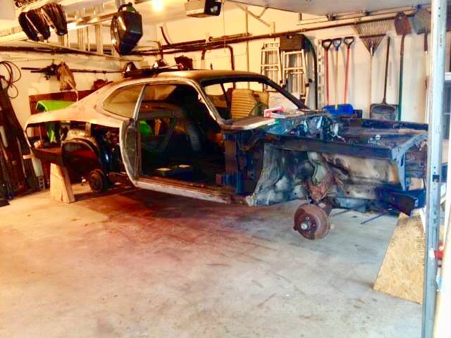

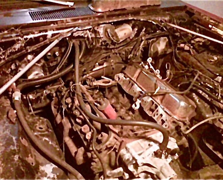

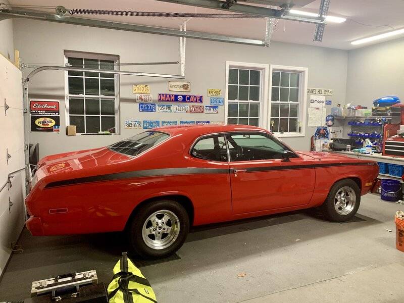

It’s all I can do to keep from pissing my pants ever time I walk past the car in the garage. It took 8 years of free time in the evenings to get the car put back together.
A few times a week I’ll slip the cover off the front of the car, open the hood and just grin. I love it !
