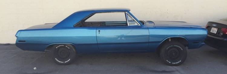

Want some ideas of what would look good with my car also please include sizing

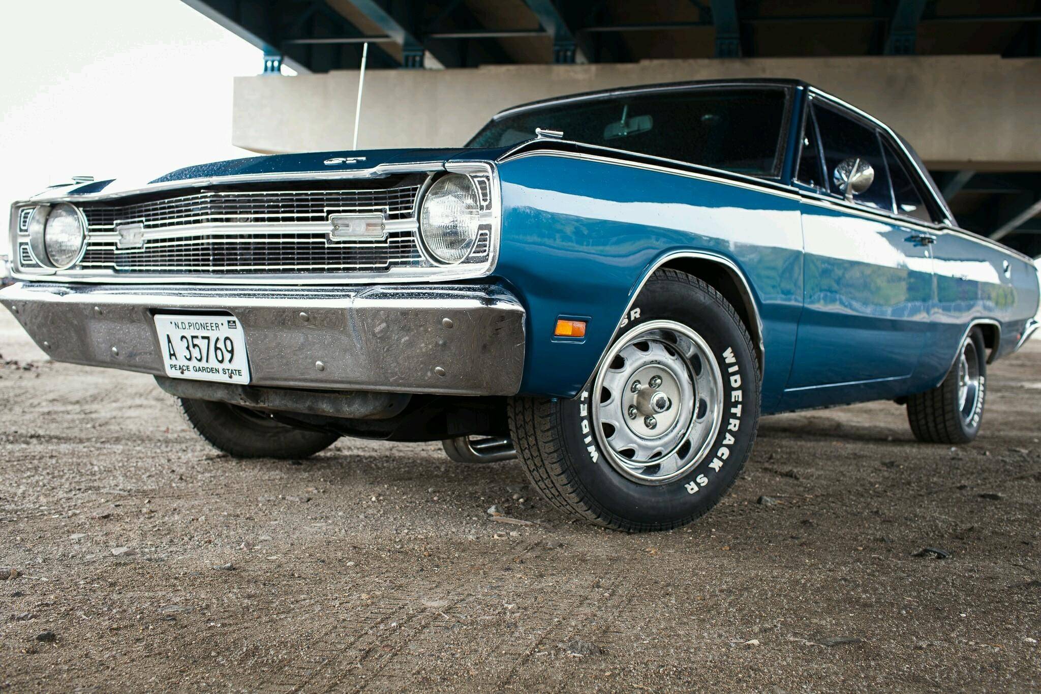

Just wanted to say, your car is killer.
I have a 69 Dart GT in B7 blue. When I ordered and bought wheels and tires for my car...I bought US Mags Ramblers. 15x7 front and 17x7 rear. Front tire size is 205-55-15 and the rear is 225-55-17 Yokohama S Drive tires.

There isn't much available in a 5x4 pattern. I guess I'd go with a rally wheel.
To me, I'd swap to 5x4.5 pattern before deciding on wheels. Your options become unlimited.

I install tires based on the traction requirements.
On the street,over 400 hp needs the biggest street tires you can find. 295/50s are barely enough. Having had several Dart/Swingers, I know they like to pendulum when you get into it. If you enjoy sliding, and freedom from penduluming you need width. Penduluming can be cool, but mostly it's just plain dangerous.For straightline traction, get the tallest that will fit.
I'm pretty sure your Dart will not accept anything larger than 275/50s for width, or 275/60s for height, at a reasonable street rideheight.Of course custom wheels will be required.
Buy the tires, stick them in there as far inboard as you dare, measure,measure,measure, and order the wheels.
A high-traffic,local, tire-shop might bring in one of each for you to fit. They did for me. If after the tires are installed, they rub on the inboard side,shims are available, to push them out a bit.
