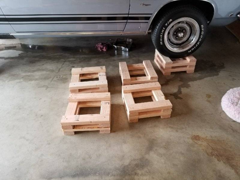

I'll add mine...
I built them in 2 stacks because i couldn't jack it high enough in one shot....
Working under it feels SAFE. Jack stands are fine for an oil change, but i never trust them...

I'll add mine...
Jeff
Good idea with the stacking. I know the wood is less likely to slide on each other but.....Could you mark them in pairs and drop a pin through to keep them together. The one photo shows a little crooked. Good idea and thanks for the photo. Craig
