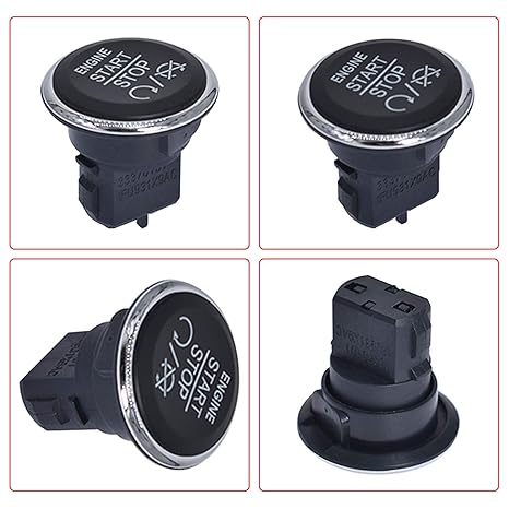

Do either of those setups use a push button starter? That might explain the brake light wiring on the one and the WIN setup. Start signals would more than likely be CAN based for a push button setup since they prevent you from re-engaging the starter once the engine is running if you push the button again. Guessing those would probably be coming from a BCM, though maybe that's the WIN module. I'm not as familiar with all the various modules in the cars today off the top of my head.
The WIN was used on all '08-10 cars. Here is what it looks like:
Not sure what the '11+ models used, but I know the '06-07 use a more conventional switch with power in and out only. The WIN is connected to the CANBus and also controls things like remote starts and such while the '06-07 switch does not connect to the network.
Interestingly, the push to start feature on this generation of cars is really just a button plugged into the same hole as the key, and it can be removed.
The push button option does require the brake pedal to be pressed to start the car, but the regular key does not. Not really sure why. Either way, the brake input isn't from the WIN, it's actually an input to it and to the TIPM. Both are getting a power input from the brake light circuit. I didn't look up the '06-07 setup, but my guess is that there is a brake signal input to the PCM. Either way, the PCM controls the starter motor by grounding the control side, but in the '08-10 TIPM the starter relay control is powered by the TIPM and the TIPM has to want to supply that power.
There really is a fair amount of overlap between the functions of a BCM and the TIPM, both store and apply features and options for the configuration. I guess the only real difference is the BCM is a circuit board inside the car with a front and rear PDC while the TIPM is both the front PDC and BCM. But there isn't a separate module in the car that functions like a BCM does in the '11+ cars. Best guess is that the separate BCM was introduced at the same time they went to the GPEC2 PCM.
It would probably be more accurate to call both the '06-07 and '08-10 setups a TIPM. I've been using the label FCM for the earlier ones, but really that is a part of the fuse and relay box and together they make a TIPM. So the big difference between the two styles is the circuit board on the earlier ones isn't integrated and could be removed.
Ah, okay. I'm familiar with that key style as my parents' Ram had one. Interesting that the push button was set up like that. Would make sense for the WIN to control the remote start stuff as well, and it has the same kind of functionality to prevent starter engagement if the engine is already running (though I guess now that I think about it, the PCM is really probably the one that would carry that logic). Pretty wild how limited in scope some of those modules would be. The WIN feels a little silly because ultimately you're not saving much by using it. You'd still need a minimum of 4 wires (power, ground, CAN Hi, CAN Low). If it was just a dumb switch like old cars you'd have the same number of wires or less (accessory, run, crank, etc.) and could just feed those into something like a BCM that carries the logic already. Guessing it must have been an "add-on" so they could use other existing modules and add functionality without having to alter code. Or maybe they just ran out of I/O on what they had at the time, so throwing it on CAN was an easy way to extend it until they could requote a new controller with more I/O or something like that.
