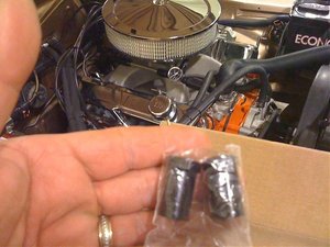

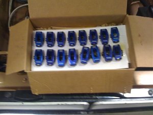

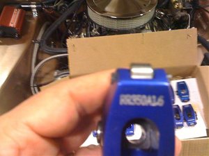

You dont need adjustable Rockers on the Magnum Heads. The adjusting nut takes care of it........I will sell you these for a good price if you want them. Brand new Never used!!!!!! These are PEP that I bought from Hughes about 18 months ago. 1.6 Ratio.......These are good QUALITY parts nothing cheap about them.
I,m not sure wether I,m going shaft or stud mount?I,ll talk with my builder and get back to you on the rockers.How much for them?My Eddy heads are also LA not Magnum.

These will not work for you then........
