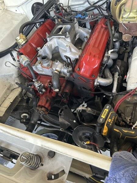

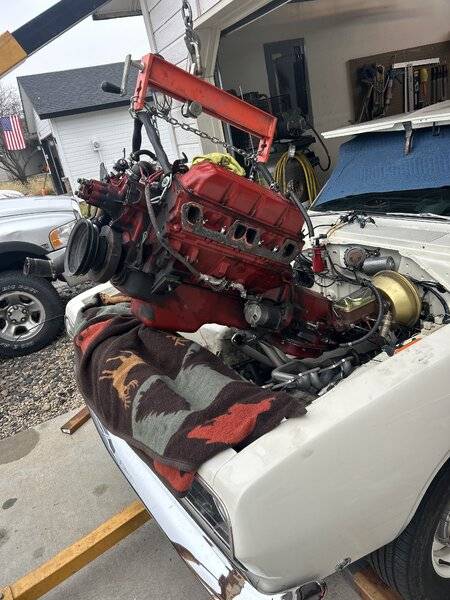

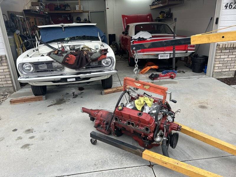

Yep ! You can tilt it as you pull it then level it off as needed to clear the header panel . Just pulled my engine last week .

I also place a furniture dolly or a creeper under tail of trany so it doesn’t drag .
