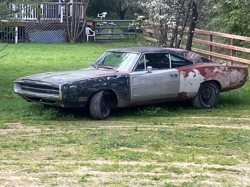

Within the past 6 months, I've aligned 3 Mopars...two Chargers and one 72 Duster. All three were able to get 6 degrees of caster with stock upper control arms. One Charger has poly strut bushings that I put in around 2003. That car has 1.15" torsion bars and Bilstein shocks and rides lower than stock so suspension travel isn't like you'd see in a 4 wheel drive. I got 6 degrees of caster with stock UCAs but switched to QA1 arms.
The other Charger has all rubber bushings. The only thing special was the offset UCA bushings. It got the same 6 degrees of caster.
The Duster....
Essentially the same as the "Jigsaw" Charger, all rubber bushings but Moog offset UCA bushings installed for maximum caster.
