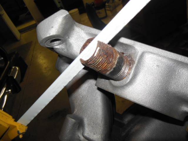

Here is a diy to remove the nipples. Ace hardware has brass fittings.
