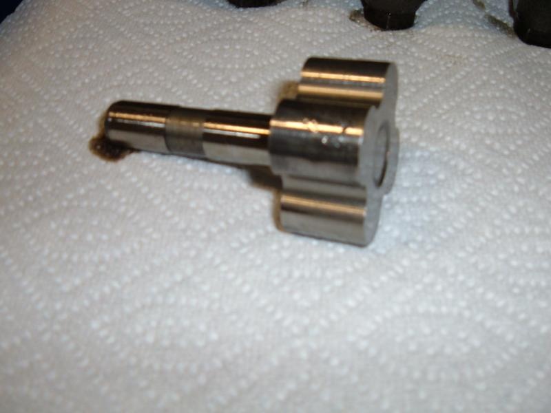

I can see that also. If that metal shard was left over from machinng and trapped in oil pump I can see that also. Something went through the oil pump. I wished he had posted a picture of the pump housing.

Check the pick up screen.....
In my early motor 360 I had a pick up screen that had a plastic button in the center of the screen.
Long story short.... A valve stem seal made its way into the oil pump and froze the pump up and sheered the oil drive shaft off at 75 mph..... I herd the valves start rattling, but by then it was too late...
So I feel your Pain Mopar brother......
On the upside- you didnt really spin a bearing. You have crap in the oil system definately... But you didnt spin it.
My take - that peice of junk may be material sheared off a cam bearing when it was installed. Did you use the right installation tool for them? The cam bearings look like crap and the cam never spun right. Bearing material could get through the pump, and is soft enough to imbed or stick to itself. If the block never went to the machine shop, there could have been some crap still in the oil galleys too. Basically, I think it was just "a matter of time", unfortunately. But, it didn't strand you, destroy the block, or really break anything important. You're only out the few parts you put in last time. Buy a book or two, follow what they say to do, and you should be fine.

Was the gear pinned? those un pinned factory gears sometimes slip when used with a HV pump .
